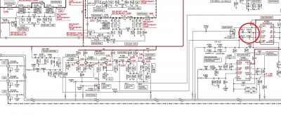

Why do the modification?
[list=disc]
  • up to 200 watts.
  • less spike effect.
  • no splatter.
  • no "pup effect" in voice modulatin.
  • warm normal.
  • power adjust normal.
  • roe protection normal.
  • AT works normal.
  • very easy to do and you can revert it.
  • Disclaimer Notice:
    The following modification should be done by qualified personnel at the owners risk. I am not responsible for any damage to, or illegal operations of the equipment as a result of mod errors or possible mod misinformation via this page.
    REMOVE BOTTOM COVER
    1. Find C810 smd condenser near Ic802 ( N 4 in TX-RX unit component side view, front radio side). C810 is a large smd 10mF unit.
    2. Solder a 1K resistor across C810 terminals WITH "PIGGY-BACK" METHOD (DO NOT remove the original C810), take care….
    3. Close the radio.
    4. Service menu : 23 at 185 and 24 at 255 firmware V.06 or 23 at 170 and 24 at 255 firmware V.07. I don't know why yet……you need experience something like this to your radio to menu 23 with wattmeter.
    Enjoy and let me know.
    If you don't like, you can revert it.
    Schematic to the article (10 Mb)

    C810两端并联1K电阻。
    09-10-2012 20;15;45.PDF (3898 K) 下载次数:26 09-10-2012 20;20;34.PDF (2035 K) 下载次数:25
    仅供参考,后果自负。
