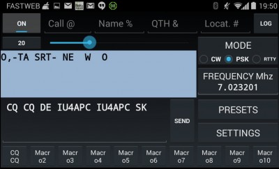

蓝牙手机与KX3无线连接的 KX3 Companion介绍 [复制链接]
只看楼主 倒序阅读 0楼 发表于: 2014-03-21
With KX3 Companion you can:
◾Send and receive CW, PSK31 and RTTY using your Android device keyboard (or even a Bluetooth physical Keyboard)
◾Read and Write messages with room for hundreds of chars (depending on your mobile phone or tablet screen size)
◾XMIT (Chat) Mode – Transmit as you type. Perfect mode to be used with an external Bluetooth keyboard.
◾Switch mode (CW, PSK31, RTTY)
◾Set the frequency and go up/down bands
◾Record and recall up to 10 totally customized macros
◾4 dynamic symbols for Call, Name, QTH and Locator to be used on macros (you can customize the symbols)
◾Set the CW WPM (Words Per Minute) value with a slider
◾Have up to 10 presets to set power, ATU or whatever you want to program
◾Customize the serial baudrate, dynamic symbols and date formats to adapt the app to your setup and needs
◾Record and share full QSO logs (everything you send and receive is recorded and saved in a text file)
◾Log your QSO in CSV format and send them via email or to any external service supported by your mobile device (log date, time, mode, frequency, call, name, qth and locator)
◾Compatible with Elecraft K3 as well
And that is just a start. We are planning more features like ADIF and eQSL.cc support.
详见
http://www.cqdx.ru/ham/new-equipment/kx3-companion/

我查到一个有线连接KX3的方案
https://play.google.com/store/apps/details?id=com.ftdi.j2xx.hyperterm
有FTDI的驱动,就是KX3原配线的.手机直接插线连上机器,不用做硬件改动。只需要装个这个软件,买个OTG线。
到处游荡的机器人火腿,目前在丽江
RIG:我有一堆uSDX
ANT:随时都能抄走的拉杆GP天线
离线BG6JJI
4952
只看该作者 3楼 发表于: 2014-03-21
It connects to your KX3 by using the USB Serial cable that comes with the radio. You’ll also need an inexpensive OTG Cable adapter to connect the serial USB to your mobile device. You can find them for a very few dollars. No other cables are needed!

经测试,小米盒子成功实现OTG下接USB HUB,插鼠标进行软件界面操作。插KX3原配数据线成功联机。
悲催,我的手机插小米OTG线不识别USB设备,继续研究。
