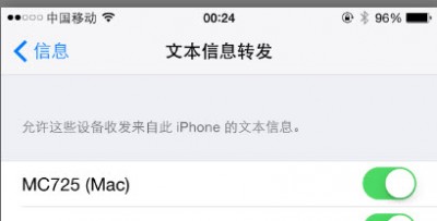

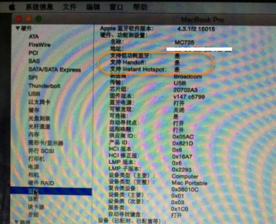

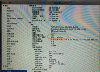

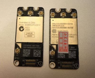

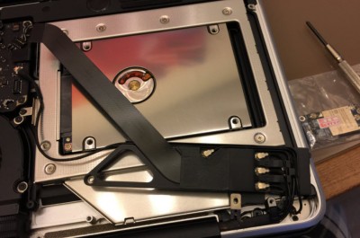

2011后期末代大飞 MC725开启handoff 手机全联动 [复制链接]
只看楼主 倒序阅读 0楼 发表于: 2014-11-09

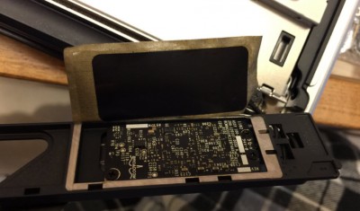

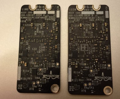

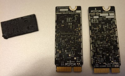

参考资料
换装蓝牙4.0模块
http://bbs.feng.com/read-htm-tid-8209820.html
Continuity Activation Tool.zip开启
http://bbs.feng.com/forum.php?mod=viewthread&tid=8485308

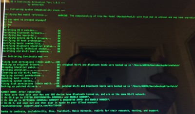

只看该作者 1楼 发表于: 2014-11-09

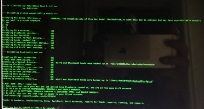

Continuity Activation Tool 1.0.2
https://github.com/dokterdok/Continuity-Activation-Tool/
最新版本v1.0.2上传
v1.0.2 -2014.11.07 Continuity-Activation-Tool-master.zip (178 K) 下载次数:0

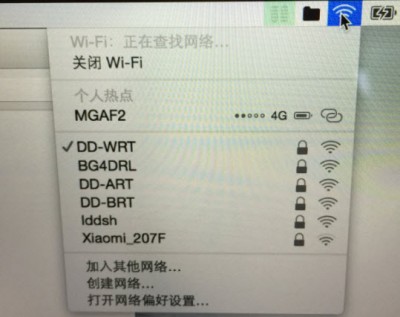

只看该作者 2楼 发表于: 2014-11-11
MD213 2011
待望的IP6热点全控终于看到.....!

只看该作者 4楼 发表于: 2014-11-13
蓝牙4.0 wifi802.11n 两项必须同步走
只看该作者 5楼 发表于: 2014-11-18
OS X 10.10.1升级后,设置需要重新 走一次 Continuity Activation
以下是今天公开的修复内容
News - 2014.11.18
• OS X 10.10.1 update: It is safe to upgrade, but the tool must be re-applied after the upgrade to get Continuity working again. More info and discussion here.
• Continuity Activation Tool 1.1.2: Released. Includes uninstallation reliability improvements. Trim Enabler users should not use the uninstallation feature from prior versions to avoid risks of issues at boot-time.
• Continuity Activation Tool 2.0 will include experimental support for 3rd party USB BT4.0 dongles. I'm looking for testers: if you are interested, please fill in this form.
https://github.com/dokterdok/Continuity-Activation-Tool/issues/44
[ 此帖被BG4DRL在2014-11-18 23:33重新编辑 ]

News - 2014.12.14
Continuity Activation Tool 2.0 released : Adds compatibility with Bluetooth 4.0 USB dongles, allowing many Macs from 2008 and later to easily upgrade to Continuity. See the chart below to verify available upgrade options.
Download link
https://github.com/dokterdok/Continuity-Activation-Tool/archive/master.zip
This tool took a lot of research and coding. A small PayPal donation would be much appreciated to support the maintenance and evolution of the app. Thanks!

只看该作者 10楼 发表于: 2015-04-15
更新贴   OS X 10.10.3 重新做 HandOff  每次升级后系统复原,需要删除备份的文件夹两个 重新生成CFG
News - 2014.12.14
下载地址:
