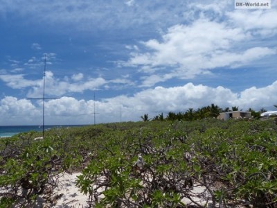

Our pilots gave some information and here ‘s what we can say:
Pileups are still big and wide, we do our best to find the best balance between rates and bandwidth usage…be sure of the fact there’s thousands still calling and the only reason we use many Khz…
We know many of you still need Tromelin for an all time new one. So narrowing pileups too much would not be good for you. Also there is no band open where we can stay “all day long”. Again today the log shows lot’s of new “uniques”. Keep your fingers crossed, you’ll make it !
Excellent propagation makes some bands open at the same time for JA – EU and NA. Everyone has his best time. We are trying to give the same chances to everyone. Some areas have narrower windows, so PLEASE respect our instructions. When you are not listening to us, everyone is just wasting time. Operators at FT4TA won’t get you if they are not calling your area. Please allow us to do a good job.
We have been able to enjoy some short openings with the west-coast on the LP, we will try again according to our propagation schedule. We will keep our efforts on low bands and try again to be on 160-80 and 40 at our SS. 80m SSB was not in our plans and we are not sure to try again as conditions on this band are not the best for SSB. Remember we are not here to give you all band/slot, so we will come again on this band/mode only if we estimate conditions are good enough for most of you.
We keep fingers crossed but haven’t faced any problem or difficulties so far. Everyone has found a good rythmn, working radio until falling asleep on the keyboard, eat, sleep, radio, repeat. I’m sure you’ve noticed most of the six stations are active all day long. Everyone is tired but over-motivated to satisfy the entire community.
Remember to give your help via our pilots. We exchange emails on a daily basis via the satellite, we do not have any other internet access (no cluster, phone, etc).
We hope you appreciate finding your QSOs on LoTW.

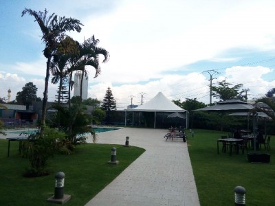

在这ibis酒店的泳池后院根gp如何?

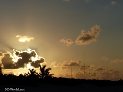

UPDATE – We are now on the final lane of our operation. We will start to dismantle most of the antennas on Sunday because all equipment must be packed and stored in big plastic cases for transportation. The boxes will be transported from Tromelin to France in the coming months. We plan to keep all stations running but not on all bands for the last night. Estimated QRT time is around 0100z Monday.
For the coming 3 days, we want to focus on stations looking for Tromelin for an All Time New One (ATNO). Even if we made our best to give opportunities to everyone, there’s still a lot of work to do and we’ll try to do it as well as possible.
We kindly ask those having already a lot of QSO with us or with past operations to give a chance to others. This is HAM SPIRIT !
17 and 20m are the best bands for an ATNO and we will try to keep 2 stations on those bands. During daylight, 20m and 17m are almost dead and start to wake-up in the afternoon and works well up to the middle of the night.
We worked on low bands with some West coast and Pacific stations at our sunrise and sunset. We will try to continue to have 40/80 and 160m at these moment +/- 1h. Today again we worked many US on 80 at our SS. We were also on 160 but with no luck. We will try agin tomorrow. We now know we have a good RX towards EU-NA, but still need to improve JA side.
We ask other stations to be cooperative. Too often, our TX frequencies get deliberate QRM, especially on low bands. We are aware of this when reports need to be sent 10 times for each station. To avoid time losses, we are doing a QSY to another band or mode. Yes, that’s a pity !
We made the request of our LoTW certificate just before our departure and sent all documentations to the ARRL HQ. Once on the island, we sent the remaining document to let them validate the certificate. We took the decision to upload immediately the log on LoTW (during the operation). This is a simple way to thank all of you for your help and support and we think that’s part of a good operation when possible.
We are now close to the 60K contacts. We are very tired due to the lack of sleep but we are ready for the last weekend ! Good luck to all of you !
