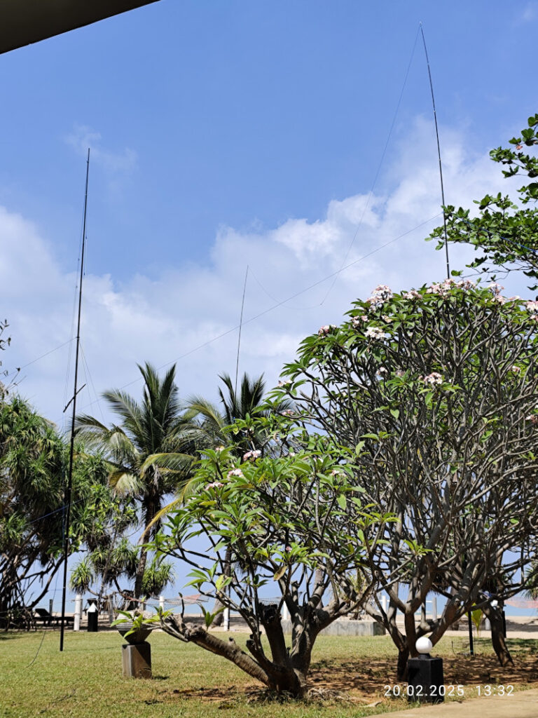

Two element phased vertical for 80m on the right, VDA for 10m & 15m on the left

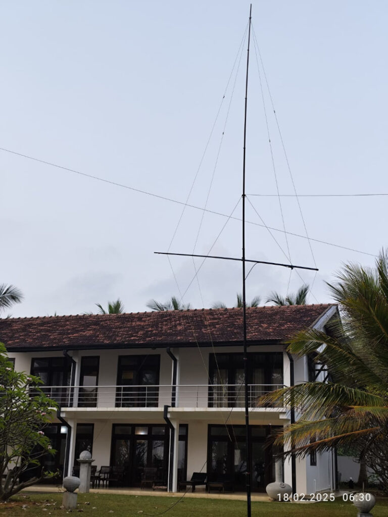

VDA for 15m and 10m

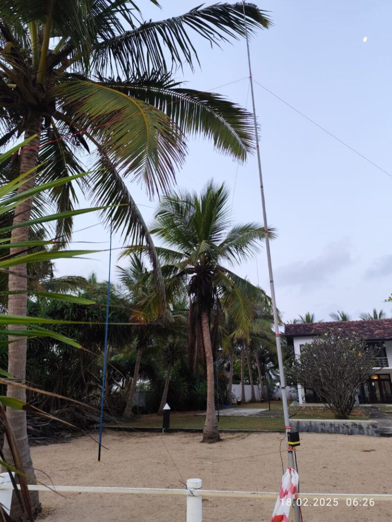

30m – 2 element vertical
